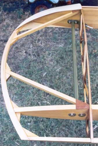

Work on 710 proceeds at a slow but steady pace here in TX with top wings built and the
bottom-left under construction. All else yet to be done. A Lyc. O-290 is resting in the
shop awaiting it's day to fly. I have a couple of jpg's of my wings.
