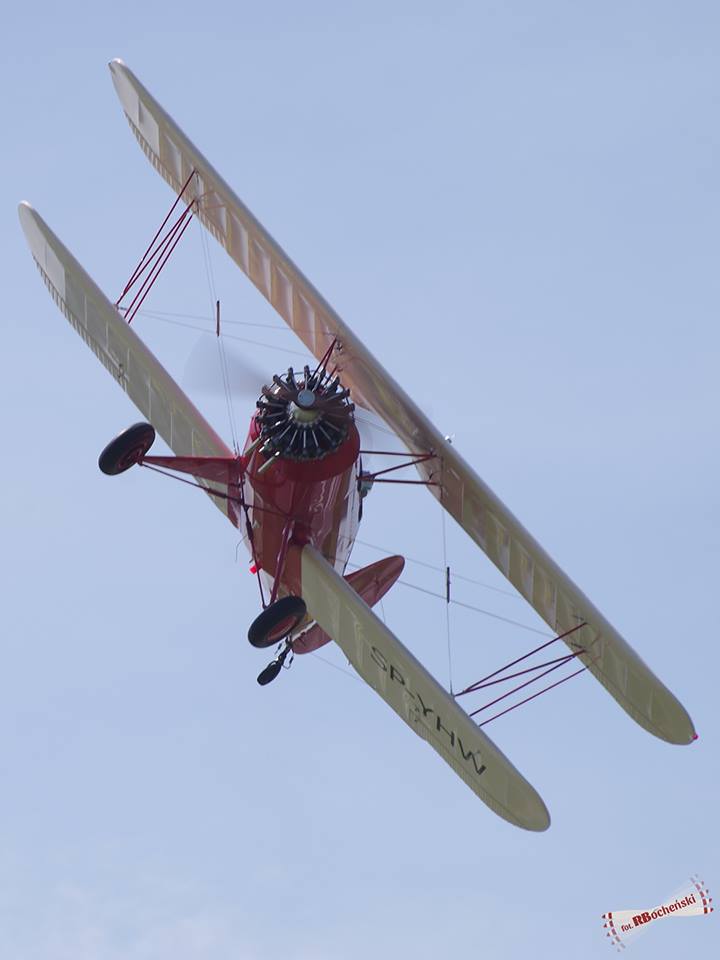

After 3 years of building, thinking, designing and realizing my own concept of biplane, my White-Red Hatz departed for its maiden flight on 15th May 2017. The aircraft just flies like a dream, making my childhood’s dream come through.

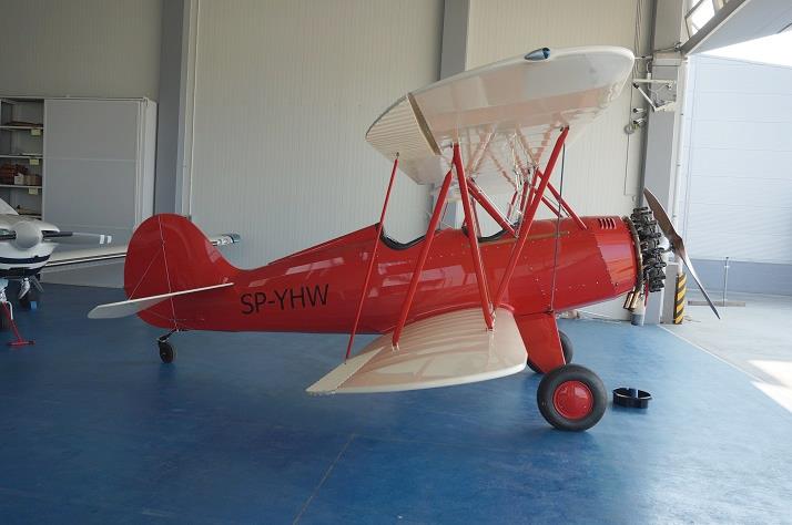

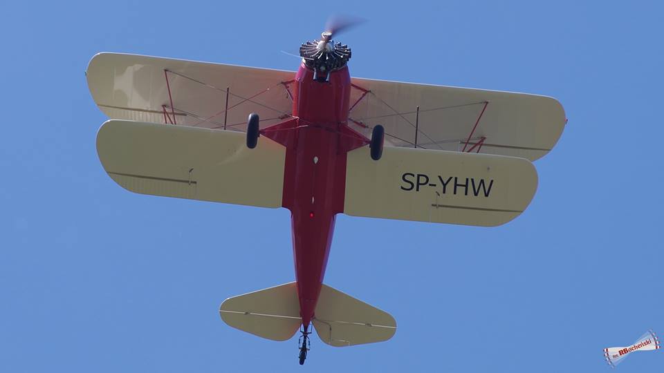

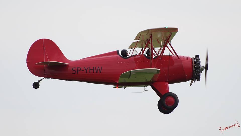

Find few pictures below and link to the film. Enjoy.
